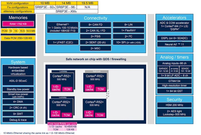

Stellar P3E block diagram
Stellar P3E block diagram.
The P3E supports an inference throughput of 80+ GOPS for suitable workloads, with optimized support for quantized integer models. The NPU operates independently of the Cortex-R52+ clusters and can be isolated at the memory and system levels to preserve determinism in hard real-time control loops, a key requirement for safety-critical automotive systems.
The architecture allows neural workloads such as classification, regression, and anomaly detection to be offloaded to the NPU, freeing the main cores to maintain motor-control and digital-power tasks. The Cortex-R52+ cluster itself delivers a CoreMark score exceeding 8,000 at 500 MHz, making it the highest-performing in its class, according to ST.
The cores support split-lock configurations, enabling dynamic trade-offs between maximum performance and redundancy. Designers can configure the system with four cores, two in lockstep, or with three cores all operating in lockstep, which meets ISO 26262 ASIL-D requirements.

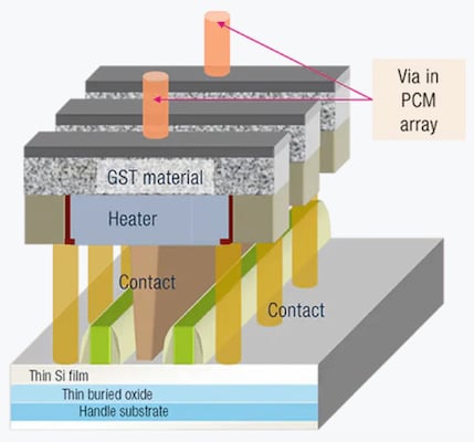

The Stellar P3E incorporates ST’s proprietary xMemory, a phase-change memory (PCM)-based nonvolatile technology that replaces conventional embedded flash. The device supports up to 19.5 MB of on-chip nonvolatile memory, including up to 19 MB dedicated to code storage and 512 KB reserved for the hardware security module.
ST's PCM technology
ST’s PCM technology.
ST says PCM provides roughly twice the density of traditional embedded flash, meaning larger code images and extensible software architectures without increasing die area proportionally.

The P3E’s peripheral set targets powertrain integration. The MCU integrates 12 separate 12-bit SAR ADCs, 10 independent 16-bit sigma-delta ADCs with embedded DSP processing, and multiple 9-bit comparators, providing more than 100 analog input channels. This density helps designers consolidate disparate functions into a single ECU, increasing functionality without sacrificing space.

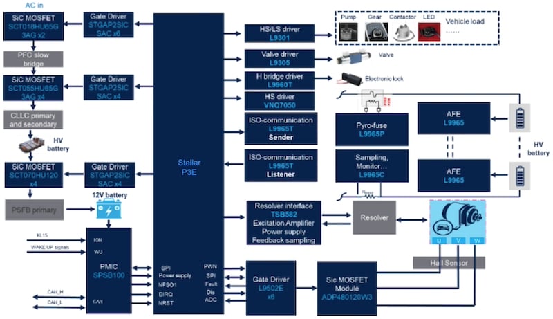

An X-in-1 powertrain domain controller solution based on Stellar P3E
An X-in-1 powertrain domain controller solution based on Stellar P3E.
