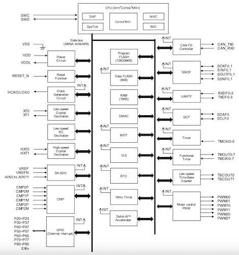

Block diagram of the ML63Q2500 series
Block diagram of the ML63Q2500 series. See page 7 of the datasheet for an enlarged image.
