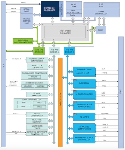

Typical block diagram for the  PIC32CM6408PL10028/032/048/064
Typical block diagram for the  PIC32CM6408PL10028/032/048/064. (Go to page 12 of the datasheet for enlarged image).
The Cortex-M0+ core runs at up to 24 MHz and supports CMSIS, enabling modular and reusable code. While developers working in MPLAB can stay within Microchip’s ecosystem, the PL10 is also compatible with tools like VS Code, IAR, Arm Keil, SEGGER, Zephyr, and MikroElektronika.
