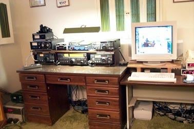

Mills seemed to have many of the quirks we associate with the most highly intelligent among us. In addition to nurturing NTP as though it were his child, he was an avid Ham radio operator, photographer, and hiker.

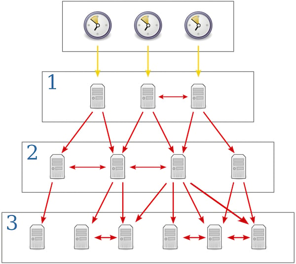

The Network Time Protocol (NTP) is a method of keeping computer clocks synchronized across a packet-switched network, where the latency between systems is unknown and unpredictable. NTP is designed to keep computers synchronized within a few milliseconds to the reference clock, Coordinated Universal Time (UTC).
In practice, it keeps systems on the public internet synced to within a few tens of milliseconds and systems on local networks within a single millisecond or less. It can operate in either client-server or peer-to-peer modes and considers multiple layers between systems and the time reference. The nodes send timestamps back and forth using user datagram protocol (UDP) on port 123.
![NTP multi-tired compare and select](https://www.allaboutcircuits.com/uploads/articles/NTP_multi-tired_compare_and_select.jpg)
NTP multi-tired compare and select. Image used courtesy of Wikimedia Commons/Benjamin D. Esham (Public domain)
The heart of NTP is the ”intersection algorithm,” a method for comparing multiple time sources and determining the most likely to be the correct source. NTP then makes this information available to clients or peers and maintains consistency despite the varying latency over public networks.
In operation, a client will poll one or more NTP servers and receive a timestamp. The client must determine the round-trip delay between it and the designated server and then calculate a positive or negative time offset from its own clock. One of the limitations of this approach is that it assumes an equal delay for the outgoing request and the incoming response. In practice, the two delays are often close but rarely equal. Research is currently underway to find a solution to this issue and deliver even more accurate time.
