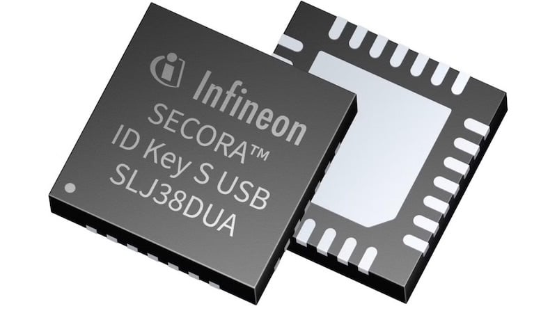

The new 4 mm × 4 mm SiP SECORA ID Key S USB
Infineon created the SiP as a part of a larger solution so customers can focus on customization and integration rather than ground-up security design. The solution includes the SECORA chip with on-board Java operating system, development tools and a configurator. SECORA comes in a 4x4mm system in package (SiP) to allow for compact application designs. It is powered by an Arm SecureCore SLC38 security controller CPU and a 48 MHz Arm Cortex M0 USB serial bridge CPU.

The SecureCore SLC38 crypto controller is a 32-bit Arm core solid flash processor designed around cryptographic security. In SECORA, it operates at 100 MHz and comes with 250kB of user non-volatile memory (NVM) and 7,392 bytes of free user RAM. NVM can be increased by 64kB if the included ISO files system is removed.
Asymmetric cryptography modes include ECC up to 521 bits and RSA up to 4096 bits. Symmetric security delivers AES up to 256 bits and DES up to 192 bits. More information is available in the SECORA ID Key S USB product brief.
