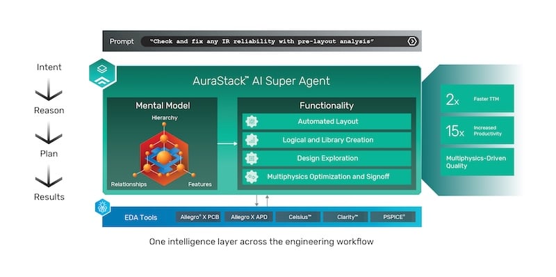

AuraStack shifts this paradigm from simple task automation to true engineering intelligence. Operating as an AI-native layer over Cadence’s trusted design and analysis tools, AuraStack leverages an underlying "mental model" of design intent. Instead of waiting for a user to trigger individual tools, the system understands the relationships between design constraints, supply chain realities, and physical layouts, orchestrating workflows concurrently.
"The agentic AI democratizes engineering knowledge,” says Mishra. “It can ask ‘Do you want me to set up your thermal analysis?' and then it will set up your thermal analysis for you, whereas before that engineer might not know how to do it."

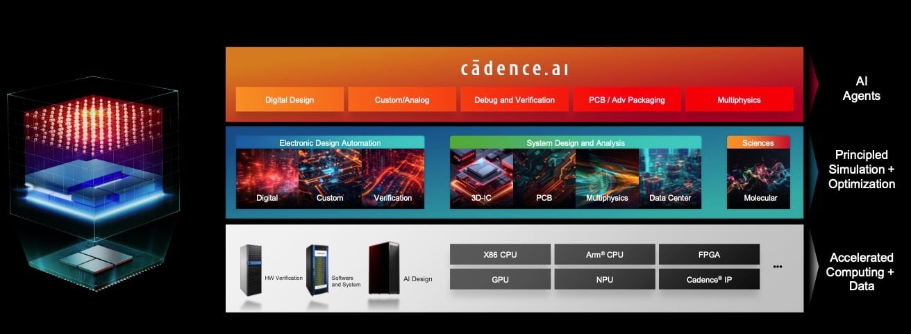

AuraStack’s framework is structured as a unified "three-layer cake" that integrates accelerated computing, native physics engines, and conversational AI:
  • The Orchestration Layer: The top layer features the agentic AI workflow. AuraStack accepts conversational natural language prompts (supporting multiple languages, including English, Japanese, and Korean) to autonomously establish goals, evaluate engineering tradeoffs, and execute multi-step modifications across domains.
  • The Physics Layer: The core consists of Cadence’s trusted multiphysics simulation and signoff engines. This includes the Celsius Thermal Solver, Clarity 3D Solver for 3D-EM, Sigrity X for signal and power integrity, alongside MSC Nastran and Marc for linear and non-linear mechanical stress, drop, vibration, and fatigue analysis.
  • The Compute Layer: The foundation is powered by custom accelerated hardware, leveraging NVIDIA Blackwell GPUs and NVIDIA CUDA architectures via the Cadence Millennium M2000 supercomputer platform.
Cadence’s “three-layer” cake approach to designing for AI and using AI for design
By running these layers within a closed-loop environment, multiphysics analysis transitions from a late-stage gatekeeper to an active, real-time design guardrail.

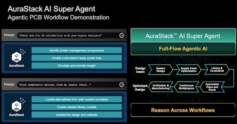

To demonstrate how the super agent manages full-flow system design, Cadence shared with us a demo of a cost-optimization workflow for a complex 5G smartphone board featuring a 66-page schematic and a 10-layer stack-up.
AuraStack AI Super Agent: agentic PCB workflow demonstration
Using natural language commands, a designer can navigate a complete optimization and layout sequence entirely orchestrated by the AI:
1. Supply Chain and Bill of Materials (BOM) Optimization
When prompted to optimize the design's BOM for cost, AuraStack acts with supply chain awareness. It analyzes discrete components, identifies redundancies, and recommends consolidating package types, yielding an immediate 28% reduction in component cost.
2. Autonomous Component Sourcing and Library Creation
When identifying alternative components, if a verified library model for a recommended power management IC (PMIC) is missing from the local database, AuraStack initiates a sub-agent. This agent locates the component from web content providers, extracts geometric and pin data directly from a raw PDF datasheet, and automatically generates the schematic symbol and footprint to update the design file.
3. Continuous Multiphysics Guardrails
Following component placement, the AI coordinates placement and routing agents while simultaneously running background simulations. During automated placement, a Celsius thermal analysis may flag structural hotspots. Rather than waiting for a manual review, AuraStack automatically calculates layout alternatives, presenting the designer with placement modifications that satisfy the thermal envelope before routing begins.
4. Interactive Place and Route
Designers can query the agent to identify unrouted high-speed nets, such as MIPI differential pairs. AuraStack analyzes existing constraints, automatically routes critical clock traces, routes the remaining interconnections, and ensures the layout passes all design rule checks (DRCs). A final post-layout evaluation extracts topology to simulate signal integrity, confirming the eye-opening meets strict operational specifications.
